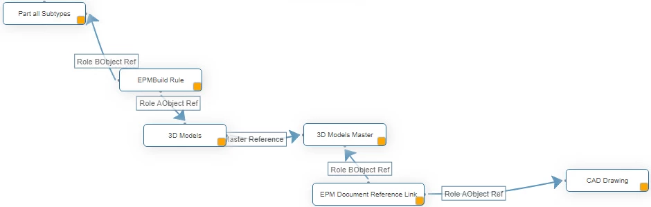

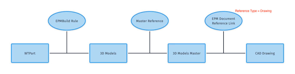

We need to fetch all the EPM Documents associated with WTPart. We are fetching this using Query Builder. Using EPMBuildRule and EPMDescribeLink, we were able to fetch association  - Content, Image, Contributing Content and Contributing Image. However we are unable to fetch the Calculated Associations. Please suggest how to fetch that data.
December 20, 2017

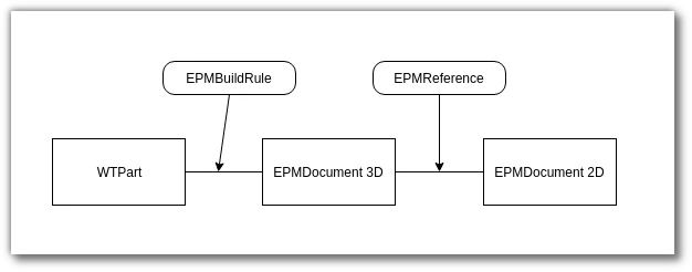

Calculated expressions are... calculated 🙂
So, if you see a drawing in the WTPart  associated objects, it's just an easier way to find it.
So you have to navigate the wt.epm.structure.EPMReferenceLink between the 3D EPMDocument and the 2D EPMDocument...
February 10, 2020
The exact model would look like this:
Or like this:
