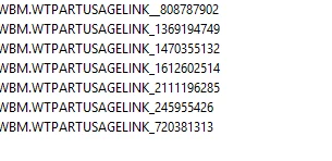

I'm Trying to migrate Non Windchill source Part to Windchill WT-Part, while trying to load the usage link Found out this
bit confused which one to use to migrate the links, I know that EPM and WT-Part has Usage Link.
While stagging wbmldr tries to check all the above-mentioned tables.

Problem was i was confused which table need to be used for populating the WTPARTUSAGELINK there are multiple tables in the stagging database.

The WTPART means that it is usage link for a WTPart type
for the EPMDocument there is a different usage type wt.epm.structure.EPMMemberLink
PS>there can be an another link type between the EPMDocument and WTPart and it is usually EPMBuildRule link.
