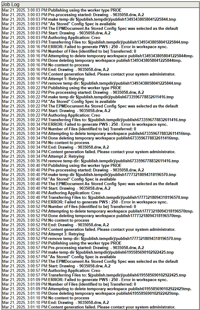

Version: Windchill 12.1
Use Case: Team members are trying to download PDF's from DWG files inside of Windchill.
Description:
Whenever a user in the Guest role tries to submit a publishing job for a dwg files default representation, the worker fails. Error Code in the job log - ERROR: Failed to generate PWS : 250 - Error in workspace sync.
These user's are members of other contexts .

I also worked on a similar error.
When checking the log files below, an error was observed in my case.
In BGMSWVS Log:
2025-03-26 18:41:10,575 ERROR [WVSPreprocessingPoolQueue.PoolQueueThread-754] wt.wvs.vcs.publish.preprocess.WindchillAccessibleCadConvert wcadmin - VCS::generatePortableWorkspace: uwgmpwsgenerator failed to generate PWS : /backup/plmdata/pubtemp/publish11880160584509461984.tmp/publish11880160584509461984tmp.pws
In Method Server Log:
2025-03-26 18:41:01,641 ERROR [ajp-nio-127.0.0.1-8010-exec-267] com.ptc.windchill.uwgm.proesrv.rrc.RequestResultProcessor windchilladmin@ticotractors.com - RequestResultProcessor.processContained :: Container is inaccessible for an object OR:wt.epm.EPMDocument:232865737 : wt.util.WTRuntimeException: (wt.access.accessResource/19) wt.access.NotAuthorizedException: ATTENTION: Secured Action. You do not have the necessary authorization for this operation. Contact your administrator if you believe you have received this message in error.
Based on these errors, the issue appears to be related to the Access Control List (ACL). Kindly check if the user has the required access provided.

From a process standpoint the guest shouldn't have the ability to generate a viewable. You should have the same ussie for CAD parts and CAD assemblies
A Guest has only limited read-only rights within a context, and it is better to stick to this Windchill Out of the Box rule.
Creating a viewable can be seen as a modification as viewable are used as a reference it should be done under control.
Your PDF should be generated by another userbefore during a checkin or during a change process or a promotion process.

Hi @Brn_The_Admin
Guest role is just for viewing the content. So a generating visualization is not allowed to the OOTB Guest role.
