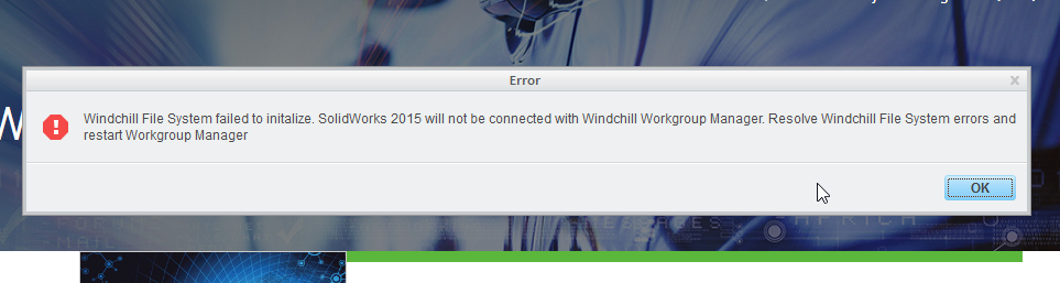

Hi All,
I just want to ask how how to fix this error while registering application in WWGM.
Thank you,
Luar

Hi Luar,
Is  "Non local drive is selected for Windchill File System"?
If YES,
  • Set environment variable PTC_WFS_ROOT=<path of a local unshared folder>.
  • Change the Windchill Folder Location in the Windchill Workgroup Manager via Tools > Windchill File System Management to a local unshared folder.
  • Windchill Workgroup Manager needs to be reinstalled if Windchill Folder Location cannot be changed.
You can also refer to TS Article CS167483 (https://support.ptc.com/appserver/cs/view/solution.jsp?n=CS167483)
Let me know, if you still observe the issue.
Pankaj Mooteri
Product Manager - PTC

Hello Pankaj,
I already change the directory to unshared folder on my local. But I cannot register the Application the error still prompt.
Thank you,
Luar
