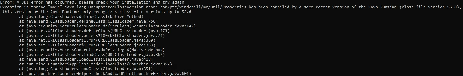

Jan 17, 2023 5:01 PM UTC
I tried to create a new shortcut and get the attached java error. Here is the shortcut path I am using:
D:\PTC\Windchill_12.0\Windchill\bin\windchill.exe -w "D:\PTC\Windchill_12.0\Windchill" --java="C:\Program Files\Amazon Corretto\jre8\bin\java.exe" shell
My "echo %path%" just has these two paths and then the normal system32 and powershell paths:
D:\ptc\Windchill_12.0\Java\jdk11.0.16_8\bin;C:\Program Files\Amazon Corretto\jdk1.8.0_342\bin;
