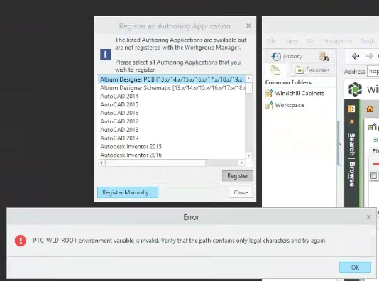

When I try to integrate Altium with Windchill Workgroup Manager (WGM), I get the following error:
"PTC_WLD_ROOT environment variable is invalid."
Has anyone encountered this issue before or can guide me on how to resolve it?

PTC_WLD_ROOT is Used by the WGM, that error looks like a path to the username issue.
have a look at this.
https://www.ptc.com/en/support/article/CS224179
