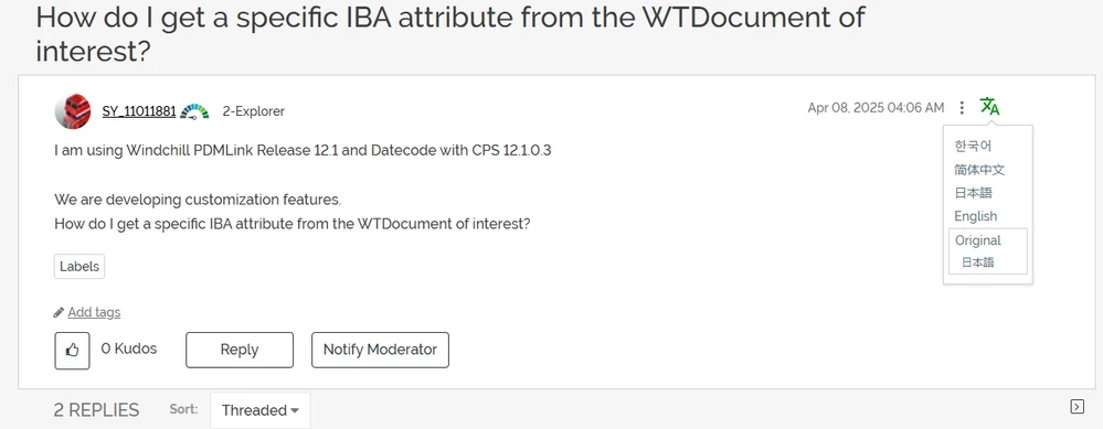

対象のWTDocumentから特定のIBA属性を取得する方法を教えてください。
I am using Windchill PDMLink Release 12.1 and Datecode with CPS 12.1.0.3
カスタマイズ機能を開発しています。

You can use this code to get the attribute value:
public static String getIBAValue(Persistable targetObj, String ibaInternalName) throws WTException {
String ibaValue = "";
try {
Locale locale = SessionHelper.getLocale();
PersistableAdapter obj = new PersistableAdapter(targetObj, null, locale, null);
obj.load(ibaInternalName);
Object ibaObj = obj.get(ibaInternalName);
if(ibaObj != null)
return ibaObj.toString();
else
return ibaValue;
} catch (WTException e) {
e.printStackTrace();
String error = "Error while fetching attribute value with message= "+e.getMessage();
return error;
