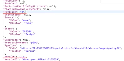

In this example, customer wants to output ”Iteration“:1,
like the ”Revision“
But seems attribute "Iteration" is not in Parts.json,  is it possible to output "Iteration"?

Then you need to customize the RestAPI and add what you need if it can not be set OOTB.

Yes you can substring the version attribute.

Do you mean by modifying the Parts.js or Parts.json under Windchill\codebase\rest\ptc\domain\ProdMgmt\v6\entity?
Sorry I still don't know how to achieve it.
Could you please teach me more in details?

I don't know where you call the rest api but you can just change the result in your application so you read the version output and you just grab the value after dot in your target application. .
