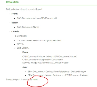

AR_0111-GarnetAuthor
11-Garnet
Sep 10, 2024 10:07 AM UTC
I saw the solution .. only I'm not familiar with SQL query and I wouldn't know how to create it and where to insert it ...
MarcoTosin
Sep 5, 2024 9:53 AM UTC
11-Garnet
Sep 20, 2024 3:37 PM UTC
can you help me find all the tables and join for my search?
MarcoTosin
Sep 20, 2024 8:03 PM UTC
Have you taken a look at the article?
It is all written down and, at the end, there is even a ready-made example report.
Marco
