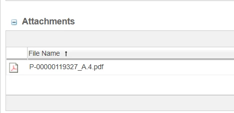

Accessing and Replacing Attachments in CADDocument Drawings via WTDocument APIs
There are various API variations, such as POST, PATCH, and GET, for attachments in WTDocument within the REST APIs in WRS to perform operations on the document. My question is: Can we access the attachments in the drawing located in CADDocument through WTDocument? If so, can we replace the document there, such as a PDF file, with another file? If we can do this, how do we establish this connection?

Hi @ozclkonur
If the REST API is designed for a WTDocument, then it is just for the WTDocument and can not accept different type as a EPMDOcument.
You should look to the EPMDocument REST API if there is something to manipulate with the attachments on the EPMDocument
