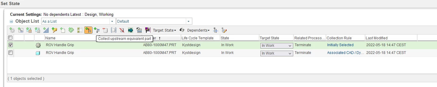

For changing a part in an subassembly in an assembly I am using the set state function from "released" to "in work" and this is working well. However, for the collector I would like to collect all affected assemblies "upstream" and use set state on these as well in the same operation.
I have a button named "collect upstream equivalent part", but it seems locked by a setting and nothing happens when I click this button. Is the function of this button according to wanted solution? Where do I activate this button?
This option should only be valid for administrator and should be set under "my preferences" then logged in as admininstrator?
BR Arild

Hi @AN_9350055
To understand why this collect button does not work from your point of view is that this works for Manufacturing WTPart which is connected to Design WTPart by Equivalence link.
So generally it is a MPMLink collecting function.
Hope this explanation can help.

We use wtparts and have auto associtation during checkin. Is the function of the collect upstream under WTParts?
Please see the attachment. I would like to be able to collect all the parents from the part called AB80-1000M47 during set state. How can I collect these parts?
Nothing happens when clicking the upstream collection button.
Best Regards Arild

To unlock a preference you need to log into Windchill with the site administrator user, then right-click on it and finally uncheck it as shown in the image.
Marco
