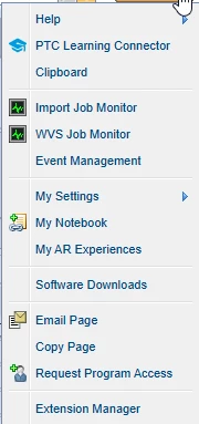

Nov 1, 2024 6:39 PM UTC
Definitely possible. I have added a new action for requested access. Its some what involved but each piece is not too hard. You need to defined a new action in the "header actions" model which you can extend in config/actions/custom-actionModels.xml and define your action in custom-actions.xml. What I am showing is a variation on "add to Team" customization that you can find discussion of here: How to add a custom action to the home page "Quick Links" menu in Windchill PDMLink.
