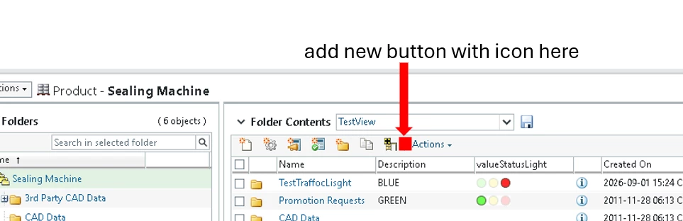

Hello everyone, I'm using Windchill 13.1.4.0 Rev 01 (a virtual machine downloaded from the PTC website). I'd like to create a button (with an icon) to insert into the Windchill Contents folder so that clicking the button modifies an attribute of the selected row. The figure below shows the panel where I'd like to insert the button.
I tried adding an action in custom-actions.xml and custom-actionModels.xml, but nothing appears. Any suggestions?
BR

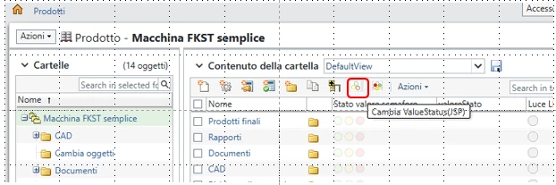

I found the solution: in the custom-actions.xml file, I added…
<objecttype name="custom" carlType="custom">
      <action name="changeStatusLightAction" selectRequired="true" multiselect="false">
         <command class="com.ptc.core.ui.resources.NullCommand" method="execute" url="netmarkets/jsp/custom/changeStatusLightWizard.jsp" windowType="popup"/>
         <icon>netmarkets/images/custom_icons/changeStatus_14.png</icon>
         <label>Cambia ValueStatus(JSP)</label>
         <tooltip>Cambia ValueStatus(JSP)</tooltip>
         <includeFilter name="all"/>
      </action>
   </objecttype>
while in the custom-actionModels.xml file, I added…
<model name="folderbrowser_toolbar_actions" incremental="">
      <action name="changeStatusLightAction" type="custom" shortcut="true" insertAfterActionName="WFADDTOWORKSPACE" insertAfterObjectType="folder"/>
</model>
Below is an image of the added button.
