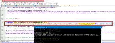

    edit advancedSearch.wt.workflow.work.WorkItem property in SearchableAttributesByType.properties.xconf to add thePersistInfo.modifyStamp :
    run xconfmanager -p and restart :
    good luck
