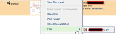

SOLVED! I am so excited I can hardly contain myself.  avillanueva_0-1646664365843.jpeg
My AfterECRloader hook now adds the PDF to Creo View PVS structure and is accessible when you click on default representation. Process involved reading the PVS and PVM (map) files. PVS is a Structure2 file and has methods to add viewables like this:
CViewable viewable=Structure2.addViewableByViewerName(root, "document", content.getFileName(), null, 0);
You then need to update the map and write our the files.
sed2.addFileMapEntry(content.getFileName(), PublishUtils.getRefFromObject(content).substring(3),PublishUtils.getRefFromObject(rep).substring(3));
Crossing fingers that this works in WC 12.
