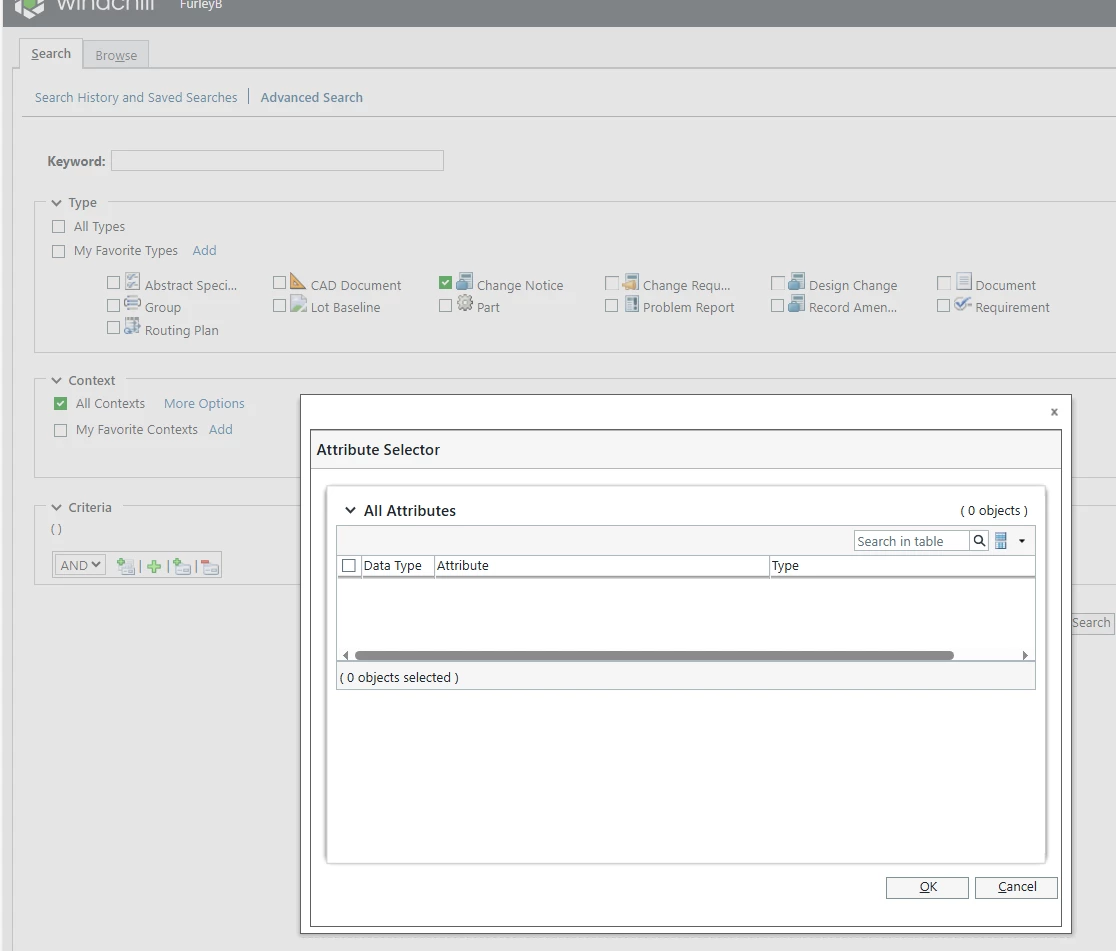

Use Case: I am trying to setup an "Advanced Search" against the "Change Notice" object type. However, I have noticed I have no option to add any "Attributes" into the "Criteria" section of my search. Please refer to the attached image.
Description:
I have noticed that I can select other object types which provides the opportunity to add attributes into "Criteria" section of the search. Can anybody suggest why I don't have this option for the "Change Notice" object type?

Hi @BF_13811900,
You need to remove the alias attribute added to the advanced search.
I have just confirmed with PTC that alias attributes cannot be added to Advanced Search.

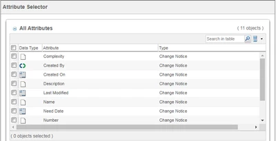

18-Opal
Jan 27, 2026 2:08 AM UTC
Hi @BF_13811900,
It works fine on my system.
I just wanted to check whether any attributes are displayed when you click on Add Condition?
Jan 27, 2026 10:20 AM UTC
Hello @TDT
Nothing seems to happen at all when I select "Add Condition"
18-Opal
Jan 27, 2026 10:26 AM UTC
Anything in Method Server logs?
