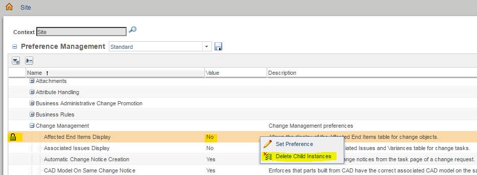

Affected End Items Display on CR displayed when set to not
Anyone know why this is.
I have set Org and Site preference for Affected End Items Display to No.
If a users creates a CR in a Folder or from an item in a folder then the CR does not contain section 2 "Affected End Items Display". If a users creates a CR from a Search result (Actions) then the CR does have Affected End Items Display.

Hi Ladric,
Go to Organization (As per the best practice, you can try to follow it in Site as well), set the preference value to 'No'.
Lock the preference and use the action 'Delete Child Instances',  that should do the trick.
Tested the option in WC11.0 M020 and its working.
And if everything fails, we can still achieve it through customization I guess.

Hi Kaushik,
That did not make a difference.
See the attached Case for details.

Hi Ladric,
In my case its working actually.
Try to do the customization then or log a ptc case.
