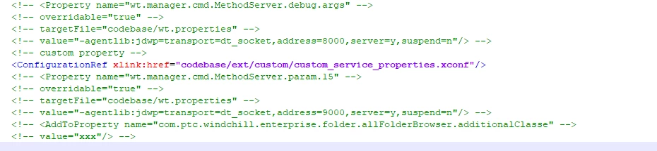

I have written a separate xconf for data utility and I have register this custom xconf file in site.xconf as shown in below image

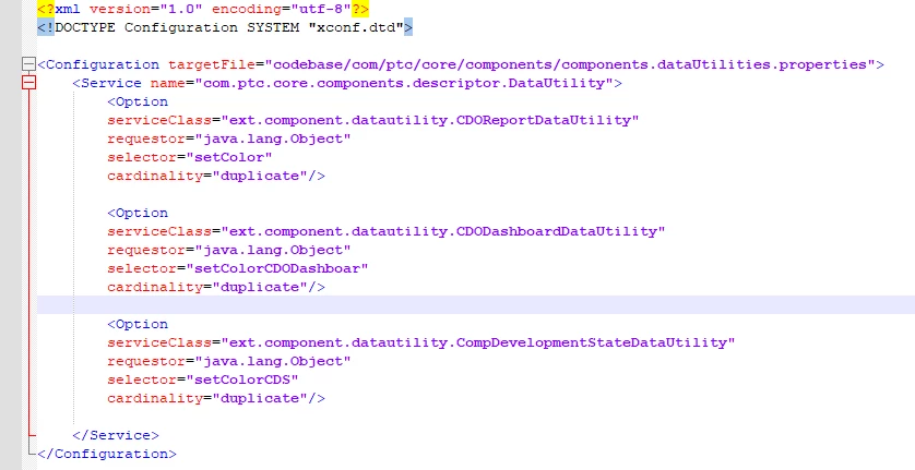

and this my custom xconf file
after I ran the xconfmanager -p the properties are not being updated in file.

I understand the xml structure, but does this structure work in Windchill? have you seen that anywhere used? because I've never used this structure
I define each option separately with all other attributes.
so I would try to define all options separately.
<?xml version="1.0" encoding="UTF-8"?>
<!DOCTYPE Configuration
 SYSTEM "xconf.dtd">
<Configuration xmlns:xlink="http://www.w3.org/1999/xlink">
<Service context="default" name="com.ptc.core.components.descriptor.DataUtility"
 targetFile="codebase/service.properties">
 <Option cardinality="duplicate" order="1" overridable="true"
 requestor="java.lang.Object"
 selector="duMySelctor"
 serviceClass="cz.aveng.MyOwnD.DataUtility"/>
</Service>
 selector="duMySelctor2"
 serviceClass="cz.aveng.MyOwnD.DataUtility2"/>
</Service>
</Configuration>
