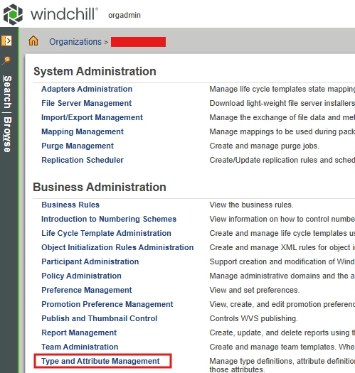

API REST SERVICE ENDPOINT for MANAGE GLOBAL ENUMERATIONS
Version: Windchill 12.1
Organization> Type and Attribute Management > Manage Global enumeration
Use Case: Hi everyone Does anyone know the API URL of Manage global enumerations or any other way to access it in API I'm using Workato and need to GET/POST to that list on Windchill Thank you
Description:
Hi everyone
Thank you

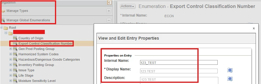

HelesicPetr
Hi @TN_13912649
You have two options.
Create own customization with extending existing RestAPI domain or create own java function that you can call by http request.
 The easiest way is creating own class where you write code that do what you need.
Following example to run the function.
public class Test1 implements RemoteAccess
	 * http to run the function
	 * http://myWCHTest.dom.com/Windchill/servlet/WindchillAuthGW/com.dom.HELTest1.Test1/ProjectsTest?IBA=123456&VALUE=0000
	 * @param req
	 * @param resp
	 * @throws WTException
	public static synchronized void ProjectsTest(HTTPRequest req, HTTPResponse resp) throws WTException, WTPropertyVetoException
		// code that does what you need.
How to search for the Global enumeration is a different issue 😄

you may also follow I*engine task https://www.ptc.com/en/support/article/CS310750
Buiꓘa
Hi @@TN_13912649 ,
@HelesicPetr  is absolutely right ( as always 🙂 ) you need to create your own endpoint for this. I’ve been working on a similar project where users can log in to a page, and only those with the proper permissions can create or delete enumerations. I haven’t finished the project yet but you might want to check out @Daniel_Ada 's this post  for more information about EnumUtils.
Be careful when creating an enumeration: make sure all required attributes are included. If any attribute is missing, you won’t be able to edit that enumeration manually later.
