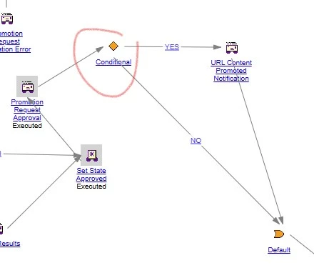

API to check if any promotables are content type URLData?
Version: Windchill 12.1
Use Case: In Promotion Request workflow, check if any of the promotables are WTDocuments with URLData as primary content. If yes, send a notification to a specific group
Description:
In a promotion request workflow, I'm trying to check if any of the promotables are WTDocuments with URLData as primary content and if so, send a notification to a certain group.  The only method I've found to possibly allow me to do this is getURLData, which returns a Vector.  Below is the code I've tried in a Conditional node in the workflow.  Testing by promoting a Document that's content is a URL, it returned result = NO

As a different approach I also tried checking the value of the attribute 2 different ways, but with both of these the workflow doesn't seem to advance beyond the conditional node which houses the code

wt.maturity.PromotionNotice pn = (wt.maturity.PromotionNotice) primaryBusinessObject;

Is this something that's possible or am I totally off the mark?  Anything wrong with my syntax/logic? Any help is appreciated.

One thing to start, I think you may want to use getPromotionTargets instead of getPromotionSeeds. Seeds are what the user initially selected to start the promotion request. More things may have been added since the initial selection. Targets will get you everything that is actually set for promotion.
I think you have an error here:
string formatName = doc.getFormatName();
		if (formatName == "URL Link") {
			isUrl = true;
Instead of:
Try:
if (formatName.equals("URL Link"){
Ref: https://stackoverflow.com/questions/513832/how-do-i-compare-strings-in-java

Thanks Joe, that was it. A simple error with a simple solution, thanks for being my 2nd set of eyes.  I also had to use the correct syntax java.lang.String instead of string, the compiler called that out easily enough

Oh, also noted about getPromotionTargets, that makes sense. I've updated that as well.  Thanks again!
