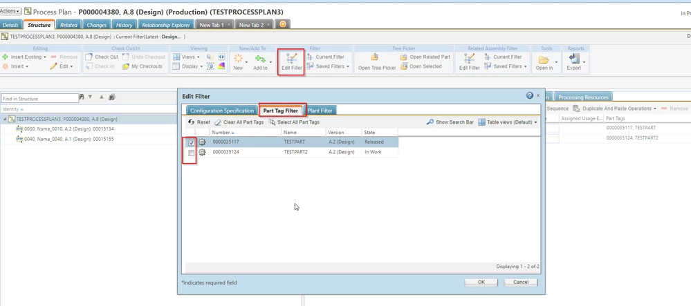

I want to fetch operation based on part tag filter(Same as Edit filter functionality of process plan)? Is there any API to achieve this?

Please refer below sample code:
ReferenceFactory referencefactory = new ReferenceFactory();
WTPart part = (WTPart)referencefactory.getReference("VR:wt.part.WTPart:xxx").getObject();
WTPartMaster partM = (WTPartMaster)part.getMaster();
QueryResult qrOpUsagelink = wt.fc.PersistenceHelper.manager.navigate(partM,"taggedBy",wt.objecttag.PartTagLink.class,true);
while(qrOpUsagelink != null && qrOpUsagelink.hasMoreElements()){
    MPMOperationUsageLink link1 =(MPMOperationUsageLink)qrOpUsagelink.nextElement();
    String op1 = link1.getOperationNumber();
Hope this helps.
