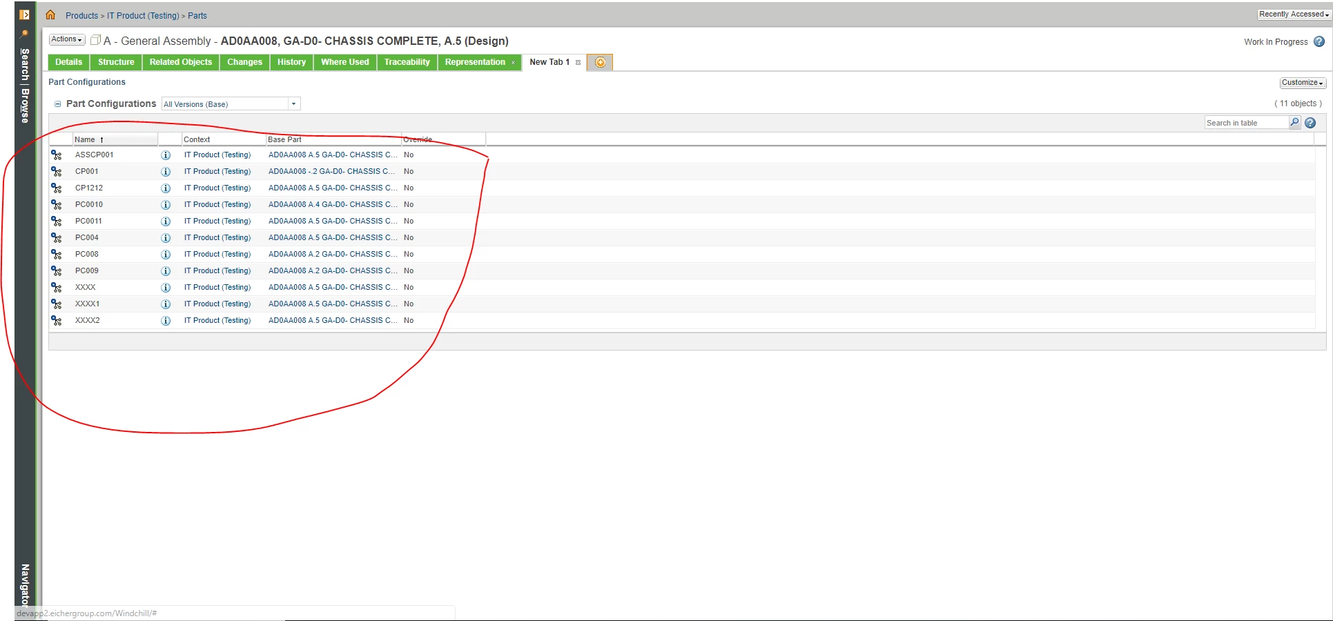

I have created two  part configuration on a part. In Part information page on "Part Configuration" tab  I can see all part configuration related to that part.
What is the API to get All Part Configuration  from part.

You can use the following snippet to achieve your requirement,
QueryResult qr = ConfigurationHelper.service.getAllConfigurations(WTPart.getMaster());
if (qr != null) {
while (qr.hasMoreElements()) {
WTProductConfiguration config = (WTProductConfiguration) qr.nextElement();
