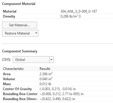

API to retrieve mass property data from published visualization data
My assumption is that the information I am looking for is contain in the .ol file. I was looking for a way to pull the mass value as an indicated that mass properties were properly done from a workflow check. Is there an API that can interact with .ol files?

Hi @avillanueva,
If you have the Creo View adapters installed locally, you could use `olstat.exe` from the command line like so:
./olstat.exe <ol-path>
 It will return triangle count, mesh count, mass data (depending on your ol file) and more.
The executable can be found in the Creo View Adapters install directory i.e. C:/ptc/creo_view_adapters_<version>/bin/
