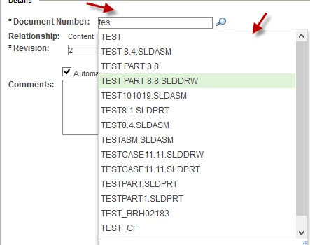

API to search functionality in jsp page to get the related Object list while entering the number
  • May 8, 2020
  • 3 replies
  • 2130 views
API to develop a search functionality in jsp page to get the related Object list while entering the number.
May 10, 2020
There is a JSP component called suggestTextBox. You can use this tag and develop your own service.
May 15, 2020
Hi bmr,
But PTC mentioned that suggestTextBox is Un-Supported API and PTC suggested to create as an Idea.
Hemanth Kumar
May 18, 2020
The tag is described in the tag-library documentation, so I guess the JSP Tag should be supported.
