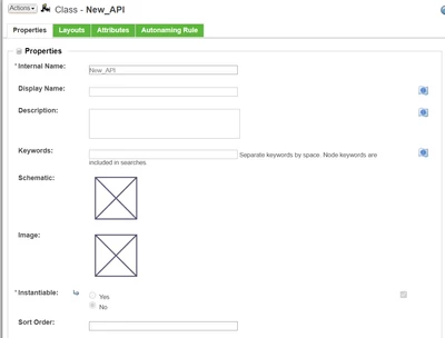

I am trying to update display name and Description of classification node throgh API.
Please suggest possible ways.

we have a list of 400+ nodes which need to be created .
I have written a code which is able to create all node by reading excel in particular format. same is  shown in above screenshot .But struggling to find a api to update displayname and description.

To get Internal name and display name.Here is the query from database.
SELECT CN.idA2A2 AS PartId, name AS InternalName, CAST(LLPV.value AS VARCHAR(1000)) AS DisplayName, CN.idA3A4 as ParentID, CN.idA2A2 as Id
FROM db_windchill_dev.LWCStructEnumAttTemplate AS CN INNER JOIN db_windchill_dev.LWCLocalizablePropertyValue LLPV ON
LLPV.idA3C4=CN.idA2A2 AND LLPV.idA3B4=CN.idA2A2 AND LLPV.classnamekeyA4='com.ptc.core.lwc.server.LWCPropertyDefinition' and
LLPV.idA3A4 in (SELECT idA2A2 FROM db_windchill_dev.LWCPropertyDefinition where name='displayName' and
classname='com.ptc.core.lwc.server.LWCAbstractAttributeTemplate')
I tried multiple APIS like below but its not updating:
TypeDefinitionReadView nodeView = TypeDefinitionServiceHelper.service.getTypeDefView(AttributeTemplateFlavor.LWCSTRUCT, "com.ptc.csm.default_clf_namespace", name);
String str3 = nodeView.getName();
TypeDefinitionNodeView typeDefinitionNodeView = new TypeDefinitionNodeView(str3, lwcStructEnumAttTemplate.getPersistInfo().getObjectIdentifier());
typeDefinitionNodeView.setDisplayName("TestDisplay");
typeDefinitionNodeView.setDescription("TestDescription");*/
