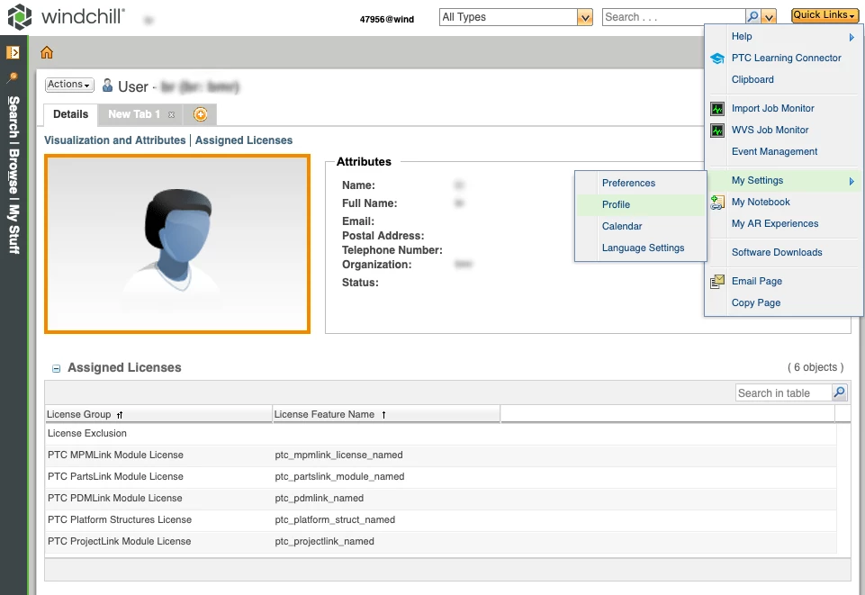

Assigned User License Example
Attached is the source code
Installation:
merge codebase/config/actions/custom-actions.xml.xml to custom-actions.xml
merge codebase/config/actions/custom-actionModels.xml.xml to custom-actionModels.xml
merge codebase/config/mvc/custom.xml.xml to custom.xml
copy codebase/com/customer/license to codebase/com/customer/license
restart Windchill
PS: please pay attention if you working with the WTSafeArea
The example has not being tested separately and has been refactored for the community. So there might be an error. Please ask if there are some coding problems.
