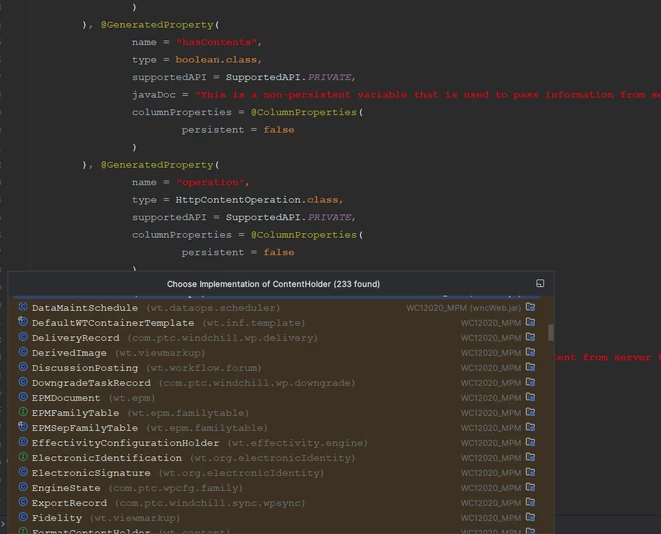

Apr 10, 2025 11:37 AM UTC
Hi Lina,
Thanks for replying.
The main purpose it as below:
  • Identify all the objects on which it is consumed.
  • If we are touch this table for any needs we can easily identify which all objects/location it will effect. This will help to take a call.
HelesicPetr
Apr 15, 2025 7:22 AM UTC
Hi @DK_11085982
All subtypes of a wt.content.ContentHolder type
You can find it in a IDE where you can track the implementation of the interface
PetrH
