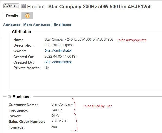

I'm trying to achieve Product Name based on attribute.
Any references thanks in advance.

I am not really sure I understand what you are asking.  Can you give more details?

Following this is pic which I'm trying to achieve.
The business attributes will be filled by the user and product name to be auto-populated.
Durga

I think this can be done with object initialization rules. Note, I have not done this personally, but as I read it, it appears you can have the Product Name generated from a combination of the attributes you enter in. At least, initially.
http://support.ptc.com/help//wnc/r12.0.2.0/en/index.html#page/Windchill_Help_Center%2FObjRuleObjectNumberCreateGenValueConstAttrDefine.html%23
