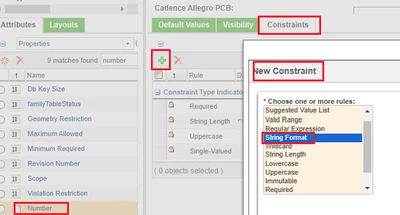

Hi @Markh74
You can try to use a constraint String format for your String attribute or Regular Expression
Attribute Constraint Rules
Constraints Tab
try String format syntax as CCC-CCCC-CCCC-CC-CC
or
Regular expression syntax as ...-....-....-..-..

@Markh74
You gave a pattern of XXX-XXXX-XXXX-XX-XX
I have two questions:
  • Is X any uppercase alpha character or is this case insensitive?
  • Can X be a number?
Either way I'd use a regex constraint as @HelesicPetr has already mentioned.
FYI String Format constraint is a holdover from previous Windchill versions.  PTC recommends using Regex for new constraints.
