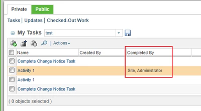

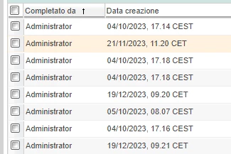

Jan 24, 2024 3:03 PM UTC
My guess is that the attribute you selected is correct but not the value you are using to fill it.
This is an example of what I see in my system for some tasks completed by wcadmin
Marco
