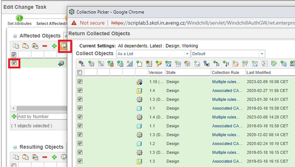

Hi All,
Trying to check the feasibility to auto-collect the affected/resulting object in the change task.
This would reduce the efforts of users to manually select each related doc, epm doc, etc.
Basically, the related objects of the WTPart should get collected.
Any suggestions/guidance appreciated.
Thanks in advance.

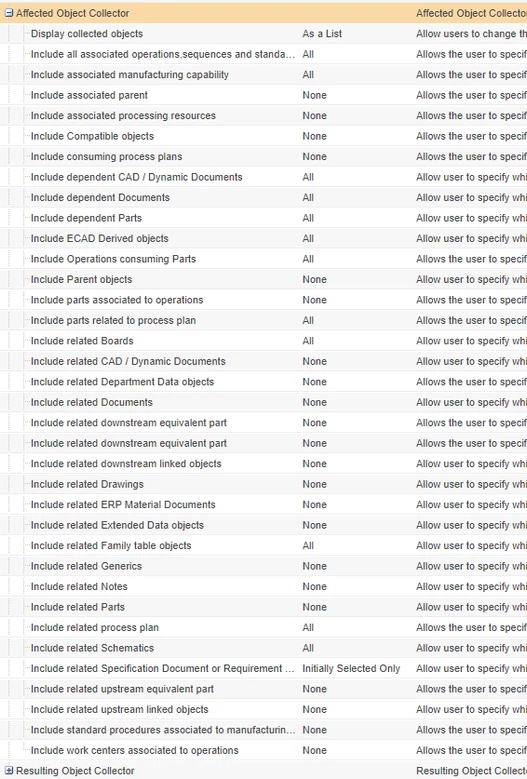

Hi @DKWc
Yes, I have a suggestion
Go to the preference management-> change management and play with the Collectors options for affected / resulting tables
Based on the options in the preference management, a function collect objects will collect all what you would need.
PS> not perfect but it works.
PetrH
DKWc15-MoonstoneAuthor
April 14, 2023
Hi Petr,
Thanks for reply.
Tried out the recommendation, however it dosen't gets collected in affected object but gets in collection.
Any suggestions to get it populated in affected objects.
HelesicPetr
April 14, 2023
Yes, It works that way.
PetrH
