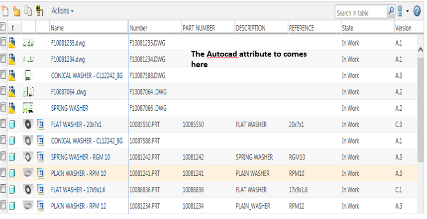

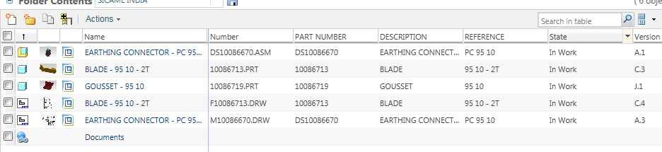

Hi Guys
Am need Autocad (2014 Standard) attribute to come in windchill system. Example am using creo 2.0, Eever drawing have  parameters like(Drawing_Number , Description ,Part_Number)
This parameters configuration to windchill system like that.
The above same thing I want in autocad drawing (Attribute to comes in windchill system & windchill system parameters to comes in autocad drawing.
Ex: PTC_WM_REVISION Parameter to call on AutoCAD Drawing.
Please help me
Regards
S.Muthukumar

Are you using the workgroupmanager for Autocad ? if yes, you can map Autocad's attributes to PDMLink ones.

Hi Muthukumar,
Yes, for AutoCAD, if you are using AutoCAD WGM, then you can map the attributes so that, it is maintained in Windchill.  For more information, you can refer to   PTC Windchill Workgroup Manager for AutoCAD Administrator's and User's Guide   (Page 114 onwards)
Pankaj Mooteri

Yes , am using WGM. But how can map with AutoCAD Attribute to windchill system.
Please explain broadly.
