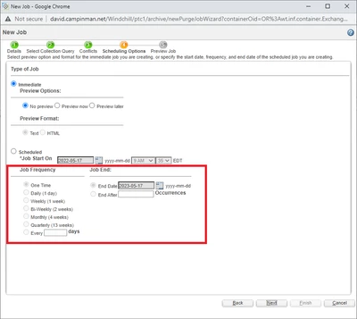

May 17, 2022
@Keerthivarman Automating regularly scheduled purge is OOTB functionality.
You need to take advantage of step 4,Scheduling Options, allows you to set the frequency of the purge job.
David
