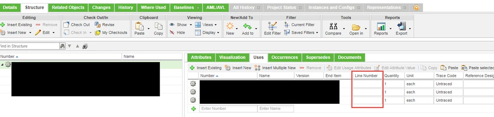

Oct 11, 2019 4:57 PM UTC
I looked through some Support articles before.. I couldn't find any automated way to do this. The closest I found is you go to the WTPart structure and click on each line item. It will "auto" number the lines you click. I want to use line items, but it's basically unusable as-is.
Oct 16, 2019 1:18 PM UTC
Can you give an example of what you are looking for?
joe_morton
Oct 16, 2019 2:26 PM UTC
Below is the Line Number field in a WTPart Structure. We could do more logic for tracking BOM  changes if we consistently used them. Example: PN 1 in line number 10 is removed and PN 2 is added in line number 10. Downstream systems could interpret that as a Replace instead of an add/remove. The trouble is, there's no automated way to enter even the default line numbers.

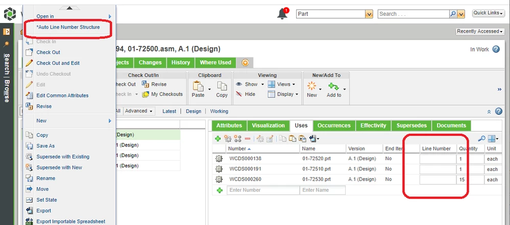

Oct 17, 2020 5:04 PM UTC
Guys, I created an action in the WTPart action menu that will do it.
I wrote the tool such that it runs only if the WTPart is checked out by the user and it is run from the Working Copy's page. If the tool is run from a non-working copy a window tells the user they need to run it from the working copy.
So, let's say you start of with no line numbers or there are some missing line numbers or whatever.
First checkout the WTPart.
Then select the *Auto Line Number Structure option.

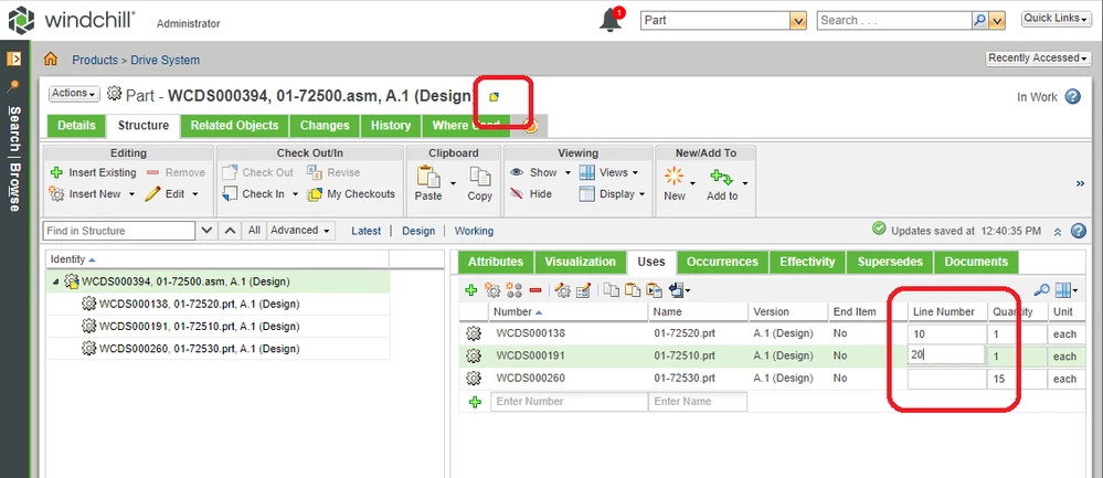

Then refresh the page.
As this is just an example, I incremented the Line Numbers by 1 but that could be whatever you want.
In this example I entered one line number just to do the checkout.

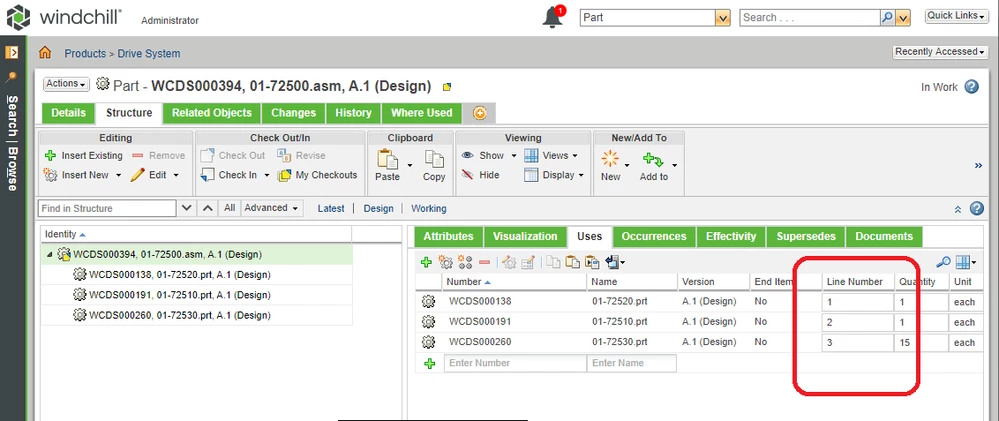

After running utility and refreshing page.
Seems to work well and can certainly do multi-level structures as well.
