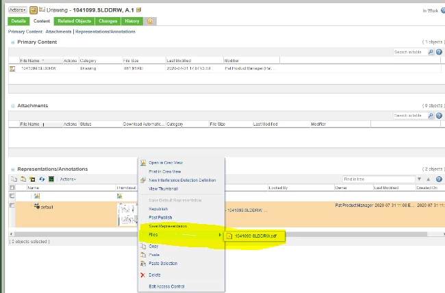

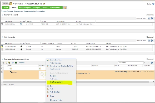

Hi everyone, what is the preference or the way in Windchill 11.2 to have the automatic representation of the pdf of a drawing? In my case with Solidworks I have the pdf created automatically (see photo 1) while for Creo Parametric and Inventor I have nothing (see photo 2). In addition to pdf files, can I also automatically create dwg or other types of files? If so, how can it be done? Thanks, Matteo.
January 15, 2021
The code word is: Publish Rules
See HelpCenter
Or
CS204223
CS111916
January 18, 2021
It is not just a preference. You first have to install a new cad worker for solidworks.
