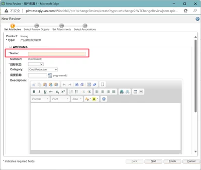

Automatically fill in Name when creating a new review
Version: Windchill 12.0
Use Case: Automatically fill in Name when creating a new review
Description:
I now need to generate a name automatically based on the selected WTPart when creating a new review. The name generation rule is  WTPart.getname + "_" + WTPart.getNumber()

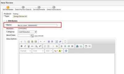

@ZK_11667139 ,
I figured out how to do this.
See images below.

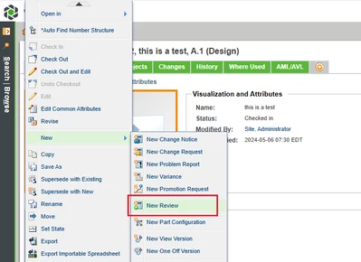

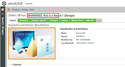

From the WTPart's info page we can see the name and number.
I then select New > New Review from the actions menu.
Per your spec, the <name> - <number> of the WTPart automatically populate the Name field in the UI.
It is doable, but I had to hack the data utility that populates that field as that data utility is not exposed to the user, meaning it cannot be overridden as is done with many data utilities.  At least I did not find a way to override it.
And to be honest, hacking the OOTB code can be simpler in the long run as there's no need to edit any properties.
So, definitely doable and easily portable to the next version of Windchill when you upgrade.

ZK_1166713910-MarbleAuthorAnswer
Oct 22, 2024 1:27 AM UTC
I have solved this problem by setting the DataUtility in the layout by assigning the Name property. thank you.
