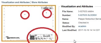

When publishing .slddrw files in Windchill, the representations are now coming out blank. This WAS working. Not sure what has changed. We did add some additional file types...see additional_file_type_publishrule.xml below.
A normal slddrw as show in _SLDDRW.JPG - this is just how it looks in Solidworks then it turns into the visualization shown in _blankoutput.jpg
NOTE: you can see the title block and some of the call outs (circled in red) appear in the visualization, but nothing else. Already looked into the following: CS48758 and CS111431 - not sure if either are related. Didn't seem to be.

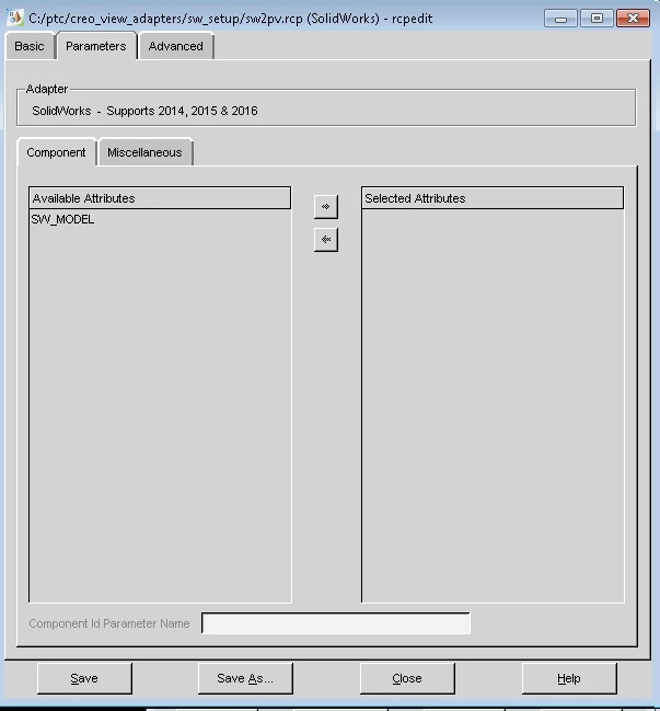

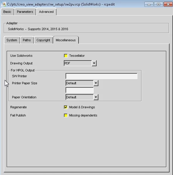

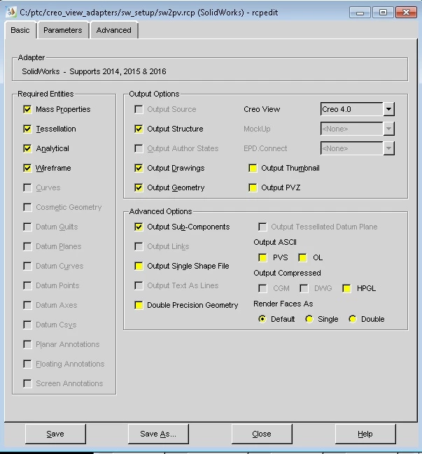

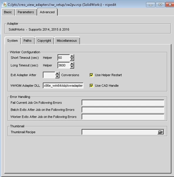

See SW recipe files - rcp1, 2, 2a, 3, 3a for current settings.
