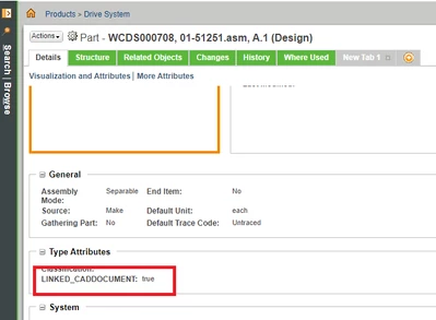

Curious if anyone has done this. It would be nice in PartsLink as users search for parts to know if there already exists a CAD model for that Part. This can be a simple Boolean but I am not sure alias or calculated attributes can work here. Has anyone does something like this or have a similar approach?

@avillanueva , hi
Yes, this is doable
You can pass the attributes that hold the values of number, revision, iteration to a custom method which then find the WTPart.
You can pass the attribute that holds the view too it that required.
Once the method has the WTPart it can determine if it's linked to a CAD Document by navigating any links you want.
The return value cannot be a Boolean however, Booleans are not allowed in the return value for calculated attributes (not sure why PTC does not allow this but they don't).
The return value can be a String.  So, maybe return String.valueOf(Boolean.TRUE).
Note: In the type manager we see lots of attributes but those are ONLY the ones PTC chose to display OOTB.  There are many more attributes available that can be used.  For example the attribute for the iteration value is not displayed in type manager but it exists and can be used to run a calculation.
Here's a WTPart that's linked to a CAD Doc.  The Part uses a Calculated attribute LINKED_CADDOCUMENT
And here's the calculated attribute.
Search view of the same part.

Hello @avillanueva
You can do it without creating own class.
Just Create alias attribute on WTpart to get number of CAD and then create Calculate attribute to show True if the alias attribute has any value.
I did it for MPMProcessPlan.
alias attribute mapping: processPlanLink~processPlan~name
calculated attribute formula: (isNull(TP_ALIAS)) ? "False" : "True"
for CAD there is following mapping:
buildTarget@wt.epm.build.EPMBuildRule~buildSource^wt.epm.EPMDocument~name

Yes, this is the approach I ended up testing and it does indeed work. I had used !(isNull(alias)) as the formula. However, this is not going to work the way I envisioned it. cs136428 cs350583 .
My goal was to have this as a classification attribute so users can filter on Parts with CAD models. This would not be something that they can search on using classification search.
