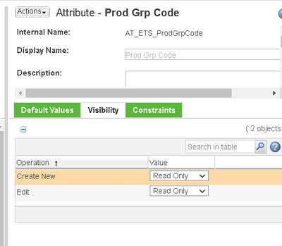

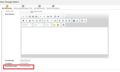

Hi @Fadel ,
thanks for your quick reply, I tried to set Change Notice Attribute visibility to read only, but when I create change notice, there is no value display, like blow:

September 28, 2023
you are right ,both type and  profile visibility produce the unassigned
