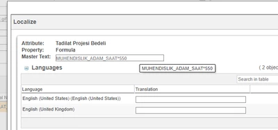

When Turkish lira is entered in Windhill, I created an attribute that multiplies this value with this year's dollar rate.
However, the dollar rate is fixed at a different value each year. For example;
In 2021 I need to multiply this value by 11, in 2022 I need to multiply it by 17.64.
How do you think I can overcome this situation? yes, I may not be able to establish a dynamic structure, but do you think I should create a new attribute every year?
Note: attribute directly affects a form and its values ​​should not change. For this reason, it is impossible for me to regularly update the calculated attribute.

Hello Onur,
 in Windchill OOTB we have the currency exchange mechanism, it is done in file Windchill\codebase\wt\units\pureSymbol.properties
there you can define the rate for currencies to dollar

Hi @Fadel
That is true, but you need to change it each year, and there is no history, isn't it ?

December 4, 2023
@HelesicPetr   yes, the rate need to be changed each year, still better than creating an deleting attribute and make changes in a downstream ERP system
