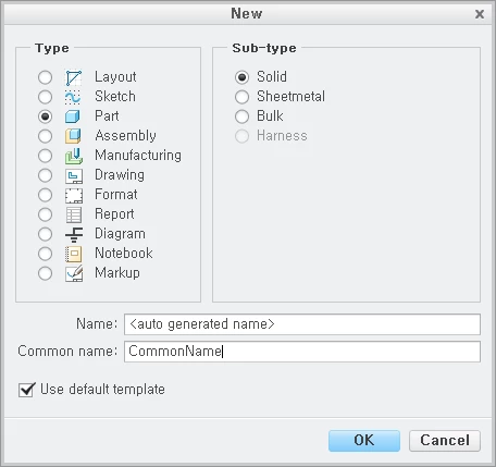

Hello, everyone
Can I use parameters for naming and numbering?
We are going to establish a naming and numbering scheme for businesses that are introducing PDM.
We are going to propose the following.
#### _ #### _ <button> .prt or #### _ #### _ <button> .asm
#### means a four-digit number.
The first four digits represent the part number, and the middle four digits represent the pid.
The last <name> will be the name of a generic model.
The 4-digit number will specify the number following the OIR in ORACLE DB.
The last <name> will be the name of the file you will enter.
In combination, EPM documents will be given a number and file name.
The public name will have only <name>.
Each type also expects parameters like parameters PTC_WC_PART_NO, PTC_WC_PRODUCT_ID, and PTC_WC_PART_NAME.
Can I use WINDCHILL PDMLink systematically to satisfy the above requirement without having to use CREATE RELATIONSHIP in CREO?
If possible, please let me know about the approach.
Thank you.

In addition, I will explain again.
I hope the results are as follows.
In PDMLink, the numbers are specified as follows:
The same is true of names.
"00007_ <CREO_PARAM_VALUE> _CommonName"
we want the file should be the format like "Common Name . Type"
So how do i write code in OIR?
