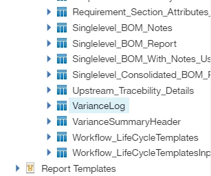

I have created a file /opt/ptc/Windchill_11.0/Windchill/tasks/ext/re/report/SB_Report/SB_SubjectReport.xml
the created Delegate
*Name :SB_SBNumber
*Name :SB_SBNumber
*Repository Type :com.ptc.windchill
Type Identifier : com.ptc.windchill.enterprise.report.ReportTask
*Source URL :/ext/re/report/SB_Report/SB_SubjectReport.xml
Description :Report Task Example to show number of document.
executed commands from windchill shell,
java com.ptc.windchill.enterprise.report.ReportHelper updatemodel and
windchill com.ptc.windchill.enterprise.report.ReportHelper modelupdate
Restarted Cognos.
Still can't find Data Source in cognos under "com.ptc.windchill.enterprise.report.ReportTask"
What is missing ? Initially I just want to pass a hardcored value.
Restarted Cognos.
