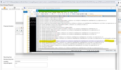

Fadel
23-Emerald II
December 19, 2023
Have you added the internal name of the  attribute in the RuleConfigurableTypeAttribute.properties file  + server restart to make it usable with OIRs , jut test it it is working on 12.0.2.15
