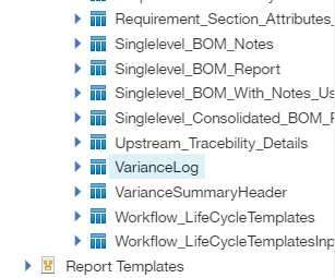

Still can't find Data Source in cognos  under "com.ptc.windchill.enterprise.report.ReportTask"
What is missing ?
