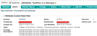

Can the attribute title be displayed in single line, without wrapping to next line?
This is view More Attributes Info Page Layout on a WTPart.
Can the attribute title be displayed in single line? without wrapping to next line.
"Package Description" as two continuous words?

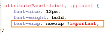

Hi @11025060
You can modify css style to set no-wrap css configuration.
Just go to the Windchill folder and modify the css file xtheme-windchill.css
...Windchill\codebase\netmarkets\themes\windchill\xtheme-windchill.css
search for .attributePanel-label
add a row to this cofiguration text-wrap: nowrap !important;
save and that's all
.attributePanel-label, .pplabel {
 font-size: 12px;
 font-weight: bold;
Check the Document Subcategory attribute
Originally rendered
Result>

Just an addition, I wouldn't change the original file, rather add a custom CSS file which then overrides this property.
See: https://support.ptc.com/help/windchill/r13.0.2.0/en/index.html#page/Windchill_Help_Center/customization/WCCG_UICust_UITechOview_AddCustomCode_JavascriptCSSFiles.html%23wwID0E5D2O
HelesicPetr
Dec 4, 2024 2:04 PM UTC
Agree @BjoernRueegg
This is the best practice.
