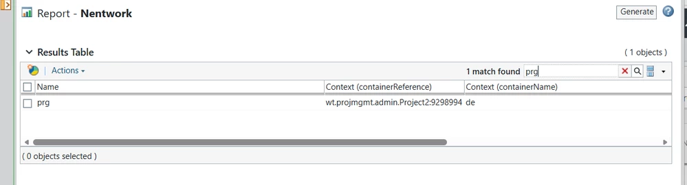

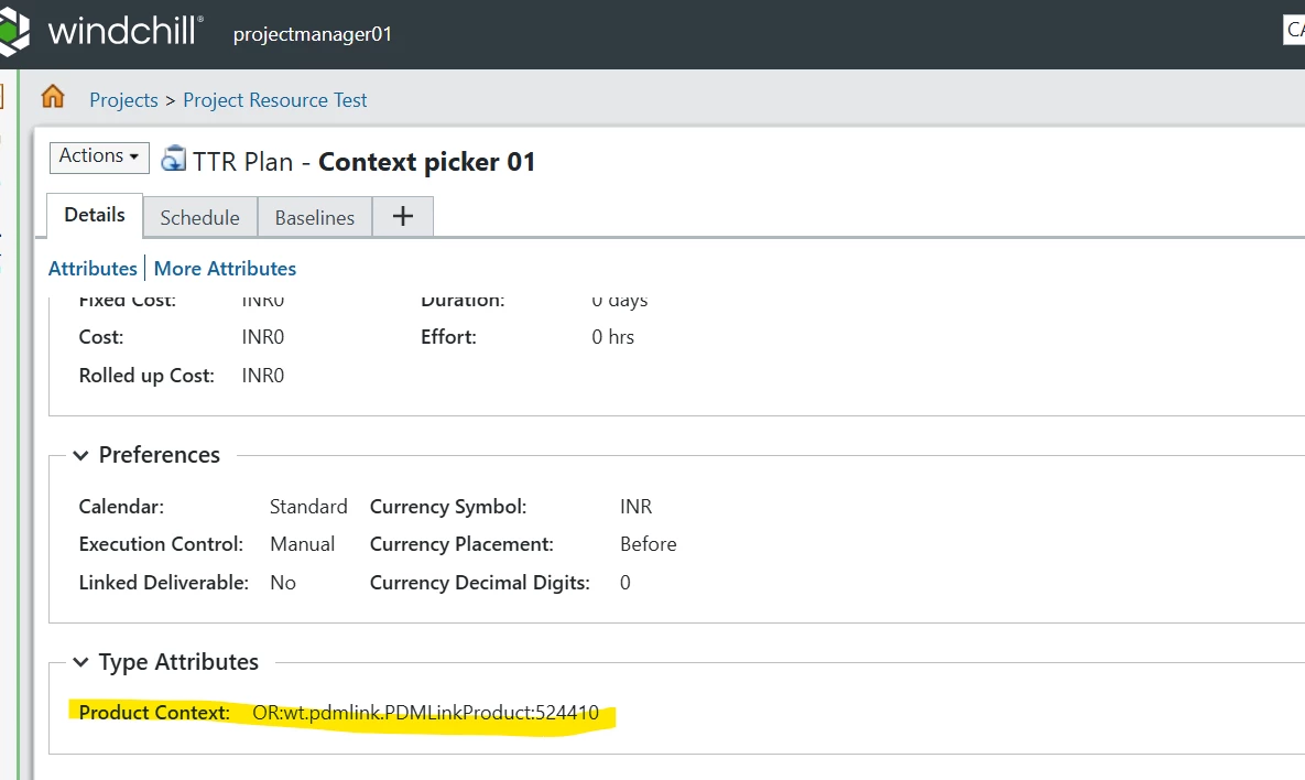

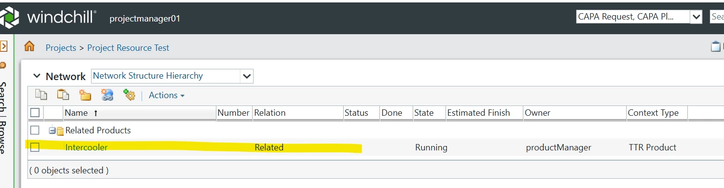

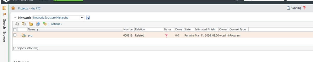

I have an attribute on Plan called "Product Context" this is a Context picker
When I select any Product there, that same product should link in Project Network
