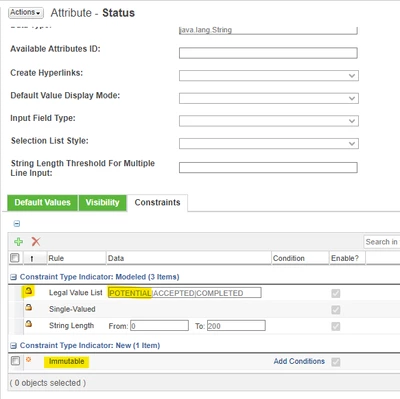

I want to rename the status value 'Potential' to 'Pending'
In Type & Attribute Management, the status of a WorkItem looks like a modeled attribute, and immutable. Is there a way to change these values?
