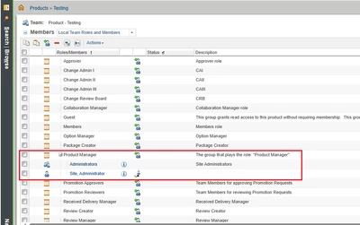

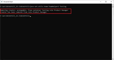

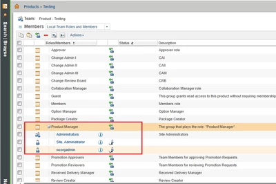

18-Opal
Sep 23, 2024 2:06 PM UTC
@PG_11148141
I wrote a utility to remove the creator from the Product Manager role.
In my test Product, "Testing", the creator is wcorgadmin.
Before removal
Run utility (which can be run automatically).
After running utility.
Note the creator, wcorgadmin, has been removed from the role Product Manager.
Seems to work.
