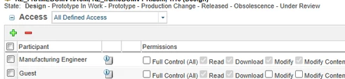

You just need to get all access that are defined on that object type.
Go to ACL manager, get all domains, and search for the type.
You would find that the permission is defined somewhere.
It is not easy because it depends on many criteria as state, domain level, roles groups and so on.
You just do not know where the definition is set.

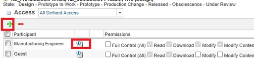

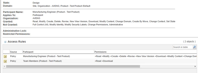

I would recommend to try to find the existing object in the specific state, and use the Edit Access Control function to get information you need by UI
Search the specific user and add him to the table and get the detail information
