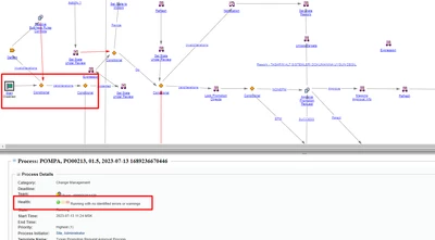

Hi @avillanueva ,
I created a code block like above, but when I add it to the stream, the process fails to start.
I don't know if I have an error in the code, I couldn't control it because it couldn't start the process.
What do you think might be the reason for the process not starting?
